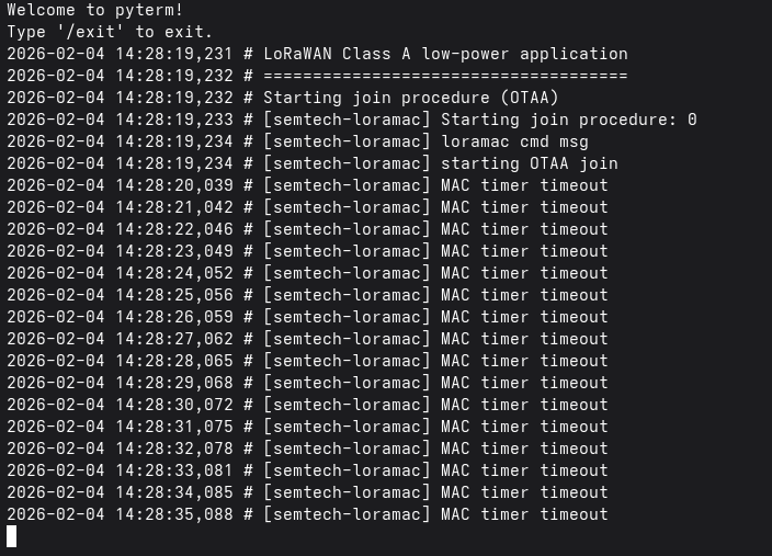

When running the program we get the log in the screenshot (starting OTAA and then repeatedly “MAC timer timeout”) everytime.
Since a deep-dive into the semtech-loramac packge didn’t really answer the question of why we get the MAc timer timeout errors and since we noticed that we’re missing a lot of debug messages that would indicate the Join procedure is actually happening, we started to wander if maybe our custom Makefiles are the problem, if maybe we aren’t really sending anything at all.

These “MAC Timer timeout” messages are the ticks of the Semtech pkg, which is used to perform steps in the internal state machine. It’s normal to see them every one second.

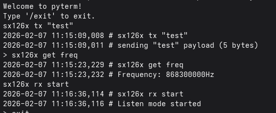

Hi, thanks for the explanation and the suggestions! I just ran the driver test and it seemed to work just fine.
(since I only had one device I just tested if the commands did something, but if the pin configuration was the problem that shouldn’t have worked, right?)
